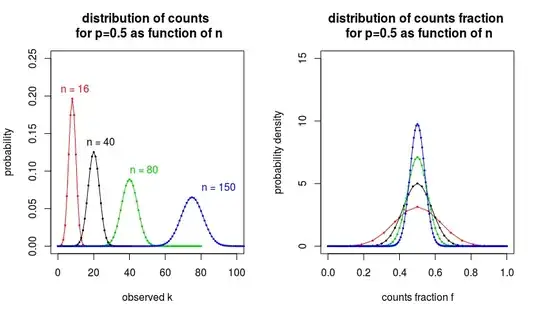

The results are consistent.
The differences in p-values that you get with trial size is as expected.
The dependency of the result on the parameter $n$ occurs because the distribution becomes more narrow.
The same relative deviation becomes less probable when $n$ increases.
See the below example (adapted from here) for the distribution of the observed number of women $k$ and the fraction of women $f$ as a function of the number of workers $n$.
example of effect of n
Related question is How to estimate a probability of an event to occur based on its count?
Consistency
The fact that the same effect size (e.g ratio of women) becomes more significant is a good thing.
This relates to 'statistical consistency'*, and this is a desirable property. It means that we can make estimates better (as much as we want) by collecting larger samples.
So that is what you did with your sample of 1150, it is a more accurate estimate of the ratio of women than the sample of 16.
*An estimator is consistent if 'The probability for the estimator to differ by a certain quantity from the true value approaches zero, when we increase the sample size'.
