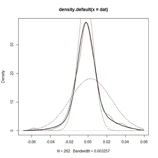

I look at the plot:
plot(density(dat),col="red")
curve(expr=pi*dnorm(x,mu1,sigma1)+(1-pi)*dnorm(x,mu2,sigma2),lwd=2,col="black",add=TRUE)
curve(dnorm(x,mean(dat),sd(dat)),add=TRUE,lty=3,col="orange",lwd=2)
which gives
quantilecorrect
It looks like, that the mixture normal (black) is fitting the data way better. The dashed orange line is the univariate normal distribution fitted to the data set. It is fitting the data not as good as the mixture density, is this correct interpreted?
Finally, we look at the single densities and compare it to the mixture:
curve(dnorm(x,mu1,sigma1),add=TRUE,lty=2,col="darkgreen")
curve(dnorm(x,mu2,sigma2),add=TRUE,lty=2,col="blue")
which gives the following plot:
densitiescompared
The first density has a higher peak, the second density is shifted to the left and has a lower peak, higher variance.
Are my calculations and interpretations correct?

    You could speed up the calculation of the quantile by about a thousand fold by using a root-finding routine. – whuber Mar 29 '13 at 16:42
    "* the second density is shifted to the left*"... I'm pretty sure that being shifted that way $\rightarrow$ is 'to the right' – Glen_b Mar 30 '13 at 01:16
  • @Glen_b yes, you are right. Any other comments are welcome, also: Is this correct what I am doing? Can I do this? I think yes? – Stat Tistician Mar 30 '13 at 08:21
    The interpretations look okay to me. – Glen_b Mar 30 '13 at 09:13
Just so this thread gets an answer (since we can't access your data any more, I don't think much more answering will be happening): what you are doing seems to be perfectly fine.
You could change your search for a quantile of a mixture to use KScorrect::qmixnorm(), as per Compute quantile function from a mixture of Normal distribution.
