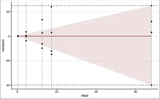

For clarity, I've added the variance visualized. The vertical, dashed black lines indicate the five groups. The red background reflects the widest to the narrowest range among the groups' variance. The red horizontal line is the trend line, not a line marking zero (although it does both, here).

  • I have graphed the variance, the distribution, the points, etc. I tried to look at this information in many different ways before putting this question out there. With the sample size so small, I am not sure if I am looking at it correctly. I added an image of the fitted versus residuals. The vertical black lines indicate the five groups. – Kat Sep 22 '21 at 20:28

  • @Kat don't worry, it's a prevalent issue in the literature, but this is a stats site, I'm a statistician, and we understand the issues with hypothesis testing. I observe two noteworthy things: the "outlier" with y-hat = 68 with resid=-40; also the box plot shows a heteroscedastic increase in variance with fitted value. You should consider the sandwich estimator to handle the heteroscedasticity. And you should fit results without the outlier as a sensitivity analysis (keep it in for the primary analysis, and comment on any difference). – AdamO Sep 23 '21 at 15:43
