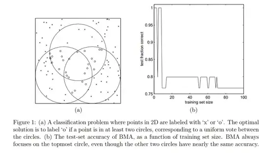

Minka (2002) gives an example where the simple average of three hypotheses outperforms Bayesian model averaging. In the below figure from the paper, the three circles represent the three hypotheses and the true class assignment is that an example is an "o" iff it is inside at least two circles.
Figure 1 (b) noted that the bigger the training set, the higher posterior probability it assigns to one of the circles (the top one), and the lower the accuracy.
His main point is that Bayesian model averaging assumes that exactly one hypothesis is responsible for all of the data and the posterior probability $P(h_i|T)$ only represents the uncertainty of which hypothesis generates the data. Even if the true hypothesis is not in $H$, as more data arrives, more and more weight will be given to the most probable hypothesis that is in H. By contrast, model combination such as bagging enriches the hypothesis space.

  • I don't get "by definition, the true hypothesis distribution is H." The hypothesis space matters. In Minka's example, if we plug in the theoretical posterior probabilities instead of learning them from data, we will still give all the weight to the top circle, and thus underperform taking an equal average of the three hypotheses. For Bayes classifier to be optimal, we need the true P(Y|X) but what we get is P(Y|X,H)=∑hP(Y|X,h)P(h), and it is only when the true hypothesis is in H do we have any hope to get P(Y|X)=P(Y|X,H) even if we know all the probabilities. – Tom Bennett Sep 18 '21 at 14:27

  • Many thanks for clarifying. For Minka's example, if we plug in the theoretical probabilities (which can be figured out because it is an artificial example), it will have the properties and be Bayes optimal, according to the claims of Wikipedia, but it will clearly underperform equally averaging the 3 hypotheses, because the true hypothesis is not in the space. Isn't that still odd? – Tom Bennett Sep 18 '21 at 17:41

  • Thanks. I think I know my exact confusion - Wikipedia states that the hypothesis represented by the Bayes optimal classifier does not have to be in H, but is the optimal hypothesis in the ensemble space. (Mitchell said almost the same thing.) But Minka's example seems to show that the hypothesis constructed using the same formula may underperform the simple average of hypotheses, when the true hypothesis is not directly in H but is the linear combination of them. These statements seem contradictory. – Tom Bennett Sep 18 '21 at 18:08
  • I found another paper that says Bayes Optimal Classifier and Bayesian Model Averaging are the same. The statistics literature calls BMA the ML literature tends to call it BOC. BOC used in this sense is how my question and the cited sources used it. It does feel different from the "everything is known" BOC definition, which I also often see. Maybe the term is overloaded. Getting more confused :-) My question that Minka's example seems to contradict the BOC being the optimal hypothesis in the ensemble hypothesis space remains. – Tom Bennett Sep 19 '21 at 01:57
