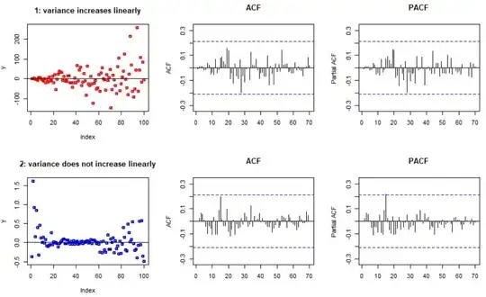

Here are 3 articles that compare ARCH models with ARIMA models. As far as I can tell each of these articles fits an ARIMA model (with constant variance) to series that come from processes with clearly non-constant variance/processes with variance that exhibits volatility clusters. I will point out that each of these articles also fits and ARCH/GARCH type model but I raise the question of whether fitting an ARIMA type model (with constant variance) in these cases makes any sense? Curiously, article 3 even concludes that the ARMA model (with constant variance) does a better job predicting than the GARCH model. What are the implications of estimating a process with non-constant variance with an ARIMA model that assumes constant variance on the validity and efficiency of statistical inference about its parameters? Do those implications differ when the variance changes linearly versus when it exhibits volatility clusters? (see plot below) Routinely you see people concluding that rejecting the null hypothesis in a unit root test (e.g. ADF) amounts to concluding that a series is stationary (instead of I(0)), once again gliding over the possibility of non-constant variance and of its implications. Both of the series pictured below do not have a unit root, and yet have clearly non-constant variance, as did the series in each of the 3 cited articles.
par(mfrow=c(2,3))
set.seed(400)
y<-rep(NA,100)
for (i in 1:100) {
  y[i]<-rnorm(1,mean=0,sd=i)
plot(y,type="p",main="1: variance increases linearly",col="red",lwd=2);abline(h=0)
u<-urca::ur.df(y=y, type = "none",lags=12) summary(u) forecast::Acf(u@res,lag.max=70,type="correlation",main="ACF",xlab="") forecast::Acf(u@res,lag.max=70,type="partial",main="PACF",xlab="") ######################################################################## y<-rep(NA,100) for (i in 1:100) { if (i<50) y[i]<-rnorm(1,mean=0,sd=2/i^1.08) else y[i]<-rnorm(1,mean=0,sd=i^2/30000) } plot(y,type="p",main="2: variance does not increase linearly",col="blue",lwd=2);abline(h=0)
