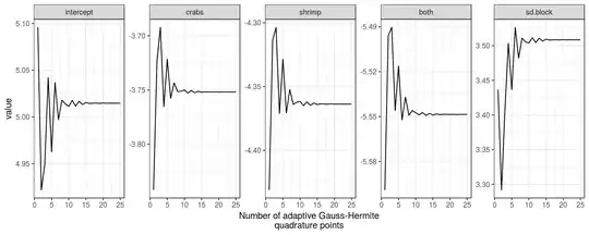

  • You have tested on similar cases where both nAGQ=0 and nAGQ=1 work and found that nAGQ=0 is generally close enough for your purposes (this is a scientific, not a statistical, criterion). There is an example here:
graph of dependence of estimated values on AGQ
