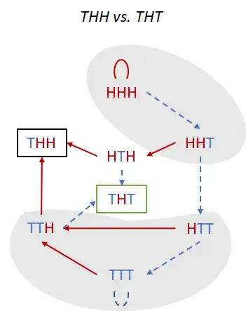

Example 2: THH vs. THT
Not all analyses are so simple. Here is the pruned graph for THH vs. THT.
Some pools flow eventually into both the terminal basins. However, there are obvious groups of pools: HHH eventually flows only into HHT. We might as well think of this as a pool with $1/8+1/8=1/4$ of the water (probability). HTT and TTT eventually flow into TTH. We might as well merge them into a pool with $3/8$ of the water. In doing these merges, we must retain all inflows and outflows. Here is the resulting "reduced graph."
Figure 4
A neat way to compute how much water (probability) ends in the THH basin is to create a "flow fractions" graph. It begins by assigning 100% of the water in THH to the THH basin and 0% of the water in THT to the THH basin. Then it works backwards through the graph. For instance, HTH splits its outflows between THH and THT. Thus, only 50% (1/2) of the water in HTH winds up in THH. The same is true for the combined HTT/TTT/TTH pool: half its water (probability) ends up in THH. Finally, the outflow from the HHH/HHT pool is split between HTH and the HTT/TTT/TTH pools. Since each of the latter contribute half their water to THH, the same must be true for HHH/HHT.
Here is the resulting flow fractions graph, drawn to parallel the reduced graph:
Finally, recall how much water begins in each pool: $1/8$ in THH, $1/8$ in HTH, $1/8$ in THT, $3/8$ in HTT/TTT/TTH, and $2/8$ in HHH/HHT. Multiplying these amounts by the flow fractions gives
$$\frac{1}{8} \times 1 + \frac{1}{8} \times \frac{1}{2} + \frac{1}{8}\times 0 + \frac{3}{8}\times \frac{1}{2} + \frac{2}{8} \times \frac{1}{2} = \frac{1}{2}.$$
Thus, the chance THH is encountered first is $1/2.$
