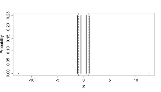

The following example shows clearly that @whuber's result is false.
Consider my "Counterexample #1" from here, with $\theta = .001.$ In that counterexample, the kurtosis is $25.5,$ the range $1-1/\kappa$ to $1.0$ is from $0.96$ to $1.0,$ yet the probability within a standard deviation of the mean is $0.5$. These statements are verified by the R code:
th = .001
Z = c(-sqrt(.155/th +1.44), -1.2, -.5, +.5, +1.2, +sqrt(.155/th +1.44))
p = c(th/2, (.5-th)/2, .25, .25, (.5-th)/2, th/2)
sum(p)       # The probabilities sum to one so it is a valid pmf
sum(Z*p)     # The mean is zero
sum(Z^2*p)   # The variance is one
plot(Z, p, type="h", lwd = 4, cex.lab=1.5, cex.axis=1.5,
        ylab="Probability")
abline(v=c(-1,1), lty=2, lwd=2)  # Shows values within +- 1 sd
k = sum(Z^4*p)
k       # Kurtosis is 25.5
range = c(1 - 1/k,1)
range     # (.96, 1.0) is the range suggested by @whuber's false theorem
          # about probability within a sd of mu
sum(p[abs(Z)<1])  # 0.5 is the actual probability within +- 1sd
Here is a graph of the counterexample distribution. The dashed vertical lines mark the $\mu \pm \sigma$ limits, within which it is clearly visible that there is only $0.50$ probability.

  • Hmmm, what about https://math.stackexchange.com/a/2523606/472987 ? There is a family of distributions where kurtosis tends to infinity and the probability is a constant .5. This seems to contradict your theorem. – BigBendRegion Aug 27 '21 at 18:14
  • @BigBend I am aware of that post. I calculated those probabilities and did not obtain 0.5. I obtained values slightly above the minimum given here. – whuber Aug 27 '21 at 18:15
  • Are you sure you are looking at counterexample #1? Because that has $Z =.5$ wp 0.25, and $Z= -.5$ wp 0.25. That is a total of 0.5 probability. All other $|Z|$ are greater than 1.0. – BigBendRegion Aug 27 '21 at 18:44
  • Either my counterexample #1 is wrong or your math logic is wrong? They can't both be right. – BigBendRegion Aug 28 '21 at 11:39
  • Use $\theta = .001$ in my counterexample #1. Then the kurtosis is $\kappa = 25.54$, and the range $[1-1/\kappa,1]$ is $[0.96,1]$. But the probability within one standard deviation of the mean is 0.5, clearly not in the range stipulated by your theorem. Your theorem is false. – BigBendRegion Aug 29 '21 at 11:48
  • Don't you think you should edit your post? As it currently exists, it is disinformation. – BigBendRegion Sep 02 '21 at 01:10
  • @BigBendRegion When I get a chance, I'll look into it. At this point I have seen no evidence that the reasoning is incorrect. – whuber Sep 02 '21 at 12:20
  • Please look at my counterexample. It shows that the result is wrong. – BigBendRegion Sep 02 '21 at 13:10
  • I have edited my post with R code and a graph to make it easy to understand. – BigBendRegion Sep 02 '21 at 14:53
    It is strange that you leave this disinformation up; people might think it is actually true. You don't need my counterexamples, as common distributions show that your claim is wrong. Take T(5), e.g., whose sd is sqrt(5/3). The kurtosis is $\kappa = 9$, so the claimed range is from 8/9 = .889 to 1.0, but the central probability is (in R code) pt(sqrt(5/3), 5) - pt(-sqrt(5/3),5), giving 0.75, well outside the claimed range. – BigBendRegion Sep 11 '21 at 15:42
