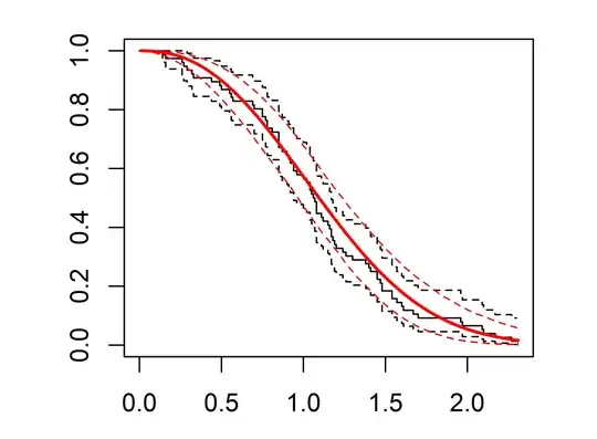

When plotting the fitted model object via plot(fitParam), it seems to match decently well with the data: Model in red, data (Kaplan-Meier estimates, I suppose) in black

  • Where fitParam comes from isn't clear, but there doesn't seem to be a very good match of predicted (red) and actual (black) survival. The predicted curve is close to the observed upper confidence interval (CI) for much of the time span; the observed curve is along the predicted lower CI for most times. And although allowing for a covariate effect on shape is allowed, that's getting beyond standard accelerated failure time modeling. Please say more about what you are trying to accomplish with your model; there might be a better approach that you are missing as "a beginner." – EdM Aug 18 '21 at 15:02
  • Thanks. I edited the question with more details. fitParam is a flexsurvreg object, as shown in the first code block. – Tester01 Aug 20 '21 at 21:50

Fourth, a single plot or a simple test value like AIC isn't sufficient to validate a survival model. For a parametric model, you need to verify that you chose the correct general form; for a PH model, you need to document how well the PH assumption holds. You need to check that you have included an appropriate set of predictors, possibly including interactions among them. For continuous predictors you need to document that you used an appropriate functional form. For the main survival package there are several types of "residuals" available to help with such checks when event times are censored, but (as you probably know) the standard survreg() function doesn't accept the counting-process data format used for time-varying covariates.
Harrell's course notes and book show ways to validate both PH and AFT models. To apply those techniques to parametric models from flexsurv or the eha package, which can accept counting-process data, you will have to do some coding. The only "residual" reported directly at this time by either package seems to be the "response" residual in version 2.0 of flexsurv, the difference between predicted* and observed event times. That type of residual can be misleading if used improperly. More useful for many AFT models are the scaled residuals,* if you also keep information about censoring versus events at the observation times. That information is in the models, but for now you'll have to pull it out yourself.
