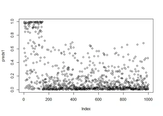

make predictions in cohort with same prevalence
predict(model,d.test_same_prev, type="response") -> preds1 plot(preds1)
