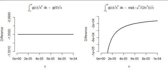

$$\lim_{\epsilon\to 0^{+}} \left[\int_{-\infty}^{-\epsilon}\frac{1}{x^{2}}\frac{1}{\sqrt{2\pi}\sigma}e^{-\frac{(x-\mu)^{2}}{2\sigma^{2}}}dx+\int_{\epsilon}^{\infty}\frac{1}{x^{2}}\frac{1}{\sqrt{2\pi}\sigma}e^{-\frac{(x-\mu)^{2}}{2\sigma^{2}}}dx-\frac{1}{\epsilon}\frac{2}{\sqrt{2\pi}\sigma}e^{-\frac{\mu^{2}}{2\sigma^{2}}}\right]=\frac{1}{\sigma^{2}}\left(\mu\,\mathbb{E}[Y]-1\right).\hspace{4em} (1)$$
This is almost the principal value of $\mathbb{E}[Y^{2}]$, except that it also includes the 'counterterm' $\frac{1}{\epsilon}\frac{2}{\sqrt{2\pi}\sigma}e^{-\frac{\mu^{2}}{2\sigma^{2}}}$, for which I, at least, have no interpretation in terms of probability theory.
