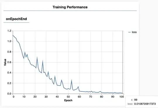

To fix the problem of the increasing loss function, I decreased the image resolution by 99.751% and made them grayscale. The images were downsized from 432 (Width) * 238 (Height) * 4 (RGBA) = 411,264 px to 36 * 36 = 1024 px.
The validation accuracy was still hovering around 53% - 80%, as I was only running 5 epochs and training with 10 samples per class. After increasing to 100 epochs and 40 samples/class, validation accuracy jumped to 91% for Linear and Quadratic instances. The loss function reached 0.01%.
