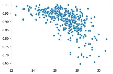

I'm trying to fit a neural net to a pretty simple 1-variable regression problem. My output is a probability and the input is a continuous feature. The association is clearly negative. The below gives
X = np.array(impute_df['runner1_speed'])
y = np.array(impute_df['dest_1__'])
sns.scatterplot(x=X, y=y);
But with the simple net below, the fitted values are positively associated with the predictor.

sns.scatterplot(x=X, y=impute_mod.predict(X)[:,0])
I must be doing something stupid but I can't figure out what. Any ideas? Thanks so much!
  • I doubt that this model has finished training. What happens if you train for 200 or 2000 epochs, possibly reducing the learning rate when it plateaus? More suggestions here: https://stats.stackexchange.com/questions/352036/what-should-i-do-when-my-neural-network-doesnt-learn/352037#352037 Scaling the data to have 0 mean and variance 1 might help the model train faster, as described in the link – Sycorax Jul 14 '21 at 15:51
  • I don't think that's it... the validation loss plateaus after about 10 epochs even with the learning rate at 0.0001 – dafrdman Jul 14 '21 at 15:57
  • A loss plateau is not a guarantee that the model has finished training. As you've demonstrated, the trend is opposite the prediction, so my inference is that the model has simply plateaued at a high value of the loss. A problem with using MSE + sigmoid output is that the sigmoid can saturate and learning will be extremely slow. Try removing the simoid activation and just using an identity activation in the output. – Sycorax Jul 14 '21 at 16:01
    Gotcha, thanks. WIth 2000 epochs the association was negative! I appreciate it – dafrdman Jul 14 '21 at 16:43
