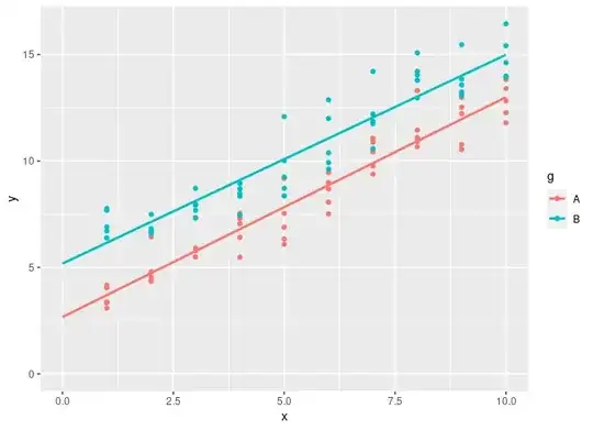

Here both lines are parallel, so we don't expect to find an interaction:
> lm(y ~ x * g, data = dt) %>% summary()
Coefficients: Estimate Std. Error t value Pr(>|t|)
(Intercept) 2.66783 0.29409 9.072 1.47e-14 *** x 1.03295 0.04740 21.794 < 2e-16 *** gB 2.51261 0.41590 6.041 2.89e-08 *** x:gB -0.05206 0.06703 -0.777 0.439
And indeed we have no interaction. And from this output we can also say:
  • The intercept for group A is 2.7
  • The intercept for group B is 2.7 + 2.5 = 5.2
  • The slope of x for both groups is 1
and this of course makes sense in terms of the plot.
