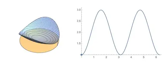

Suppose $x\in R^n$ follows the uniform distribution on the surface of a unit sphere centered at 0 and $a$ is a vector in $R^n$. What can we say about the distribution of the following quantity?
$$\sum_i x_i^2 a_i $$
Mean seems to be $\frac{\sum_i a_i}{n}$, what about the variance?
This quantity is the value of quadratic form with eigenvalues $a_1,a_2,\ldots$ when evaluated at some point on the surface of unit sphere.

  • Is $\langle x^2,a\rangle$ geometrically meaningful? Or where and how does it arise? – Matt F. Jun 25 '21 at 01:14
    @MattF. it's the value of $x'Ax$ where $A$ is a diagonal matrix with $a_i$ as diagonal entries – Yaroslav Bulatov Jun 25 '21 at 01:19
    The variance is $$\frac{2}{n^2(n+2)}\sum_{i<j}(a_i-a_j)^2$$ and the mean, as you said, is $\frac{1}{n}\sum a_i$. I may write up a proof tomorrow if no one gives a reference first. – Matt F. Jun 25 '21 at 02:53
  • Looks interesting! Proof/reference would be great. Another interpretation, it's the average value on unit circle for quadratic centered at 0 and Hessian A – Yaroslav Bulatov Jun 25 '21 at 03:04
