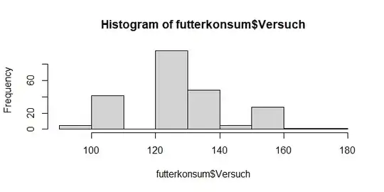

Here are the histograms (group 1 first, then group 2): enter image description here
  • Seeing the QQ plots, are the histograms trimodal? – Dave Jun 18 '21 at 14:53
  • @Dave No I don't think the histograms are trimodal. I also added them. I checked the link you posted above. According to what I could read, it really depends on how your data look like, right? In my case, I think my data are quite far away from "almost normally distributed", meaning that t-test is a no-go? – arkadryyx Jun 18 '21 at 15:03
  • Kontroll seems to have a mode around 800, another around 120, and another around 150; Versuch appears to have a model around 100, a model around 120, and a model around 160. // Perhaps the t-test is a no-go. Some people argue that we should default to the Wilcoxon Mann-Whitney U test, wilcox.test in R, so we do not have to address issues like this. – Dave Jun 18 '21 at 15:15
  • The shapes of those histograms make me wonder if a focus on the means using a t-test is going to capture all (or any) of the possibly interesting features of the groups. – Michael Lew Jun 18 '21 at 21:01
  • @MichaelLew raises a good point that I often think but rarely see discussed. You can find plenty written about the t0test being robust to deviations from normality, and you can find comments suggesting to go with Wilcoxon no matter what, since deviations from normality can be impactful and the Wilcoxon test is nearly as good as the t-test, even when the t-test assumptions hold, but there is little about how, if there are deviations from normality, differences in the mean might not be all that interests us. – Dave Jun 18 '21 at 21:35
