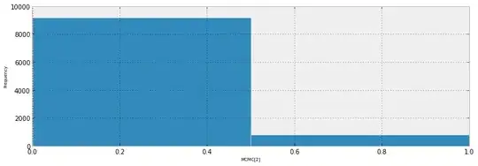

For a Bayesian logistic regression problem, I have created a posterior predictive distribution. I sample from the predictive distribution and receive thousands of samples of (0,1) for each observation I have. Visualizing the goodness-of-fit is less than interesting, for example:
This plot shows the 10 000 samples + the observed datum point (way in the left one can make out a red line: yea that's the observation). The problem is is that this plot is hardly informative, and I'll have 23 of them, one for each data point.

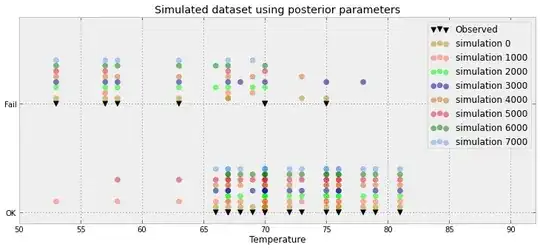

Another attempt:

  • That is alot of wasted space IMO! Do you really only have 3 values (below 0.5, above 0.5, and the observation) or is that just an artifact of the example you gave? – Andy W Mar 25 '13 at 12:33
  • It's in fact worse: I have 8500 0s and 1500 1s. The graph just pushes these values to make a connected histogram. But I agree: lots of wasted space. Really, for each data point I can reduce it to a proportion (ex 8500/10000 ) and a observation (either 0 or 1) – Cam.Davidson.Pilon Mar 25 '13 at 13:10

  • Your updated plot is close to what I was going to suggest. What is the x-axis representing though? It appears you have some points super-imposed - which with only 23 seems unnecessary. – Andy W Mar 31 '13 at 13:57
  • @AndyW the x-axis is temperature, and like you guessed, the same temperature was recorded for possibly more than 1 observation. – Cam.Davidson.Pilon Mar 31 '13 at 14:58
  • @probabilityislogic The only predictor is temperature, shown on the x-axis above (second plot). The posterior predictive distribution is currently for the observed data points, though it is possible to sample it for arbitrary temperature. – Cam.Davidson.Pilon Mar 31 '13 at 15:00
