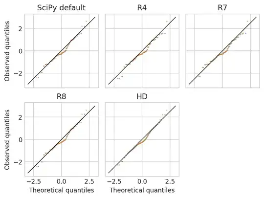

I want to assess the normality of a dataset (which is log-normally distributed data transformed back to normal) using a Q-Q plot.
I stumbled on the fact that there are many ways to build such a plot, as there are multiple ways to determine sample quantiles; and different ways to select where to place them with respect to the theoretical quantiles.
As an illustration, I generated a random sample of size $N=50$ and plotted the quantiles of this sample against theoretical quantiles. The blue dots correspond to theoretical and sample quantiles $q_a = \{1,\ldots, N\}/N$; the orange dots correspond to theoretical quantiles as per Filliben's estimate, while the matching sample quantiles are still $q_a$. The figures' titles corresponds to the way the sample quantile have been determined; R* notation references this table; HD references the Harrell-Davis estimator, which is not mentioned on the Wikipedia page. SciPy default corresponds to the default behaviour of scipy.mstats.mquantiles, which does not seem to be documented on Wikipedia either.
The orange dots of the R4 plot correspond to the behaviour of scipy.stats.problot, which plots the sorted data against the theoretical quantiles evaluated with the Filliben's estimate.
Comparison of Q-Q plots
This second figure shows these different quantile estimates against $q_a$.
Comparison of quantile estimators
The differences are rather marginal. The HD estimator seems to yield a smoother curve, which tempts me in using it, but it is a rather shallow justification.
