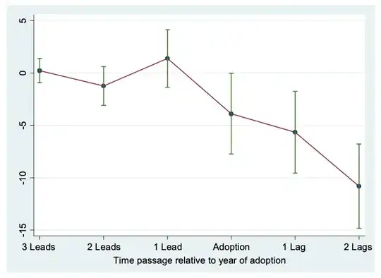

In another paper Green et al. 2015 evaluate the effects of liberalizing bar hours on traffic fatalities. Their window only considered a finite number of leads and lags, though it's a bit more balanced. Here is a figure from page 197 which reports the coefficients on the leads and lags of treatment.
Extending operating hours
They authors restrict attention to the periods around the initial adoption year. They don't expressly indicate how they modeled the endpoints, though the lead and lags of more distant periods may have been considered. Note the coefficients on the lead dummies suggest no pre-policy effects.
Note how the "effect window" varies across studies. There is no optimal lead and/or lag structure. However, in many difference-in-differences applications the authors typically include lead indicators to test for evidence of pre-trends. In table 10 of Dasgupta's work they report estimates of indicator variables from 1 to 4 years before the law is adopted. Similar to the cited research, this is a form of pre-trends testing.

  • Hi @Thomas Bilach, can I ask what does the decrease in coefficients over time in the last graph means (from Green, 2015)'s paper? – Phil Nguyen Jul 01 '21 at 01:39
    The authors tested the effect of liberalizing bar hours on traffic accidents. Their results suggest they found a decrease in accidents once bar hours were extended. Notice how the effects grow larger in subsequent periods. It suggests a growing policy influence over time. – Thomas Bilach Jul 07 '21 at 03:22
