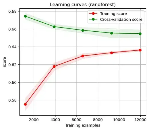

Update: comparison with Random Forest predictor
It was suggested that this problem might be hopeless. Although it is possible that with my current model, I won't adequately solve the question, it isn't clear to me if the data I have now actually supports that argument. At least it doesn't help me to interpret my learning curves.
After Frans Rodenburg's suggestion, I trained an XGBoost Random Forest classifier with default parameters for comparison. The final logloss I get is 0.636 for training and 0.655 for validation, i.e. both rather high but similar.
Additionally, sklearn's learning_curve() function gives me the following graphs for logloss, however plotted against number of training samples.
XGBoost learning curve
Random Forest learning curve

    It is definitely overfitting. The first thing I would try is to fit a completely different model to get some benchmark result. That will make it easier to see if the problem is with your data (the problem just being hard) or your classifier. For example, random forests work really well out of the box. – Frans Rodenburg May 31 '21 at 04:53
  • @FransRodenburg thank you for your suggestion. I trained a default Random Forest predictor and didn't get any better results either (see updated question). Would that already suggest the problem is "hopeless"? I think it's quite possible that the current model is too simplistic but I was hoping more complexity could make it less terrible. – Jan Wilamowski May 31 '21 at 05:52
