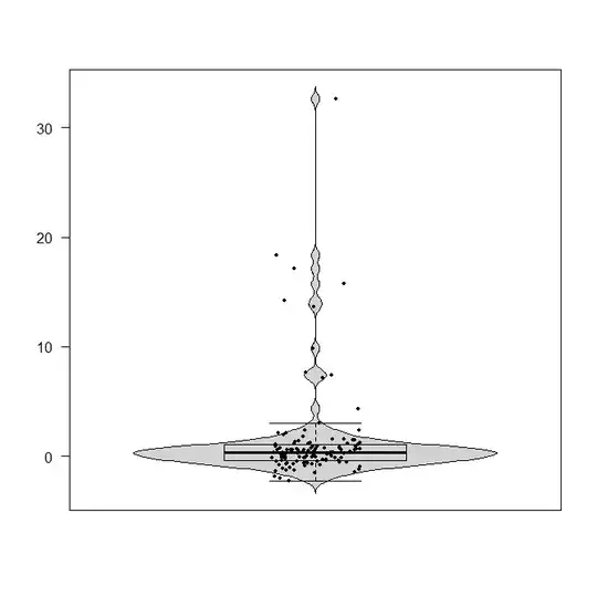

Beanplots, also known as violin plots, visualize much more information than boxplots. You can even overlay a boxplot on top of a beanplot. And if you do not have too many data points, then consider plotting all of them, possibly jittered (horizontally or vertically, as appropriate). Just ensure that if you plot both the raw points and the boxplot, your boxplot does not plot the outliers separately (in which case they get plotted twice).
beanplot
R code:
library(beanplot)
set.seed(1)
xx <- c(rnorm(1e2),rexp(20,.1))
beanplot(xx,what=c(0,1,0,0),col="lightgray",las=1)
boxplot(xx,add=TRUE,outline=FALSE,yaxt="n")
points(1+runif(length(xx),-.1,.1),xx,pch=19,cex=0.6)
