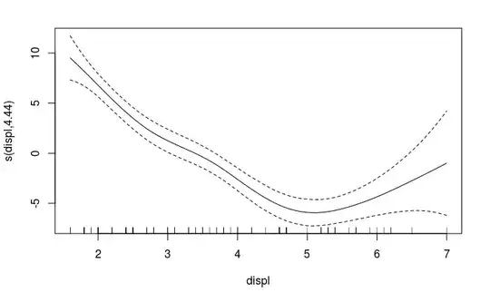

I don't have an answer for you, but a few things to consider.
First, there are some duplicates rows in the data you are using, so obviously overfitting is not such a big issue in that case.
However, removing duplicate rows won't really solve the weird behavior of AIC
    library(tidyverse)
    library(splines)
data(mpg)
mpg_unique &lt;- distinct(mpg[, c('displ',
              'hwy')])
df &lt;- 1:19
models_mpg_poly &lt;- lapply(df, function(x)
 {lm(hwy ~ poly(displ, x), data=mpg)})
 models_mpg_poly_unique &lt;- lapply(df,
  function(x) {lm(hwy ~ poly(displ, x),
   data=mpg_unique)})
models_mpg_splines &lt;- lapply(df, function(x)
    {lm(hwy ~ bs(displ, x), data=mpg)})
    models_mpg_splines_unique &lt;- lapply(df,
    function(x) {lm(hwy ~ bs(displ, x),
    data=mpg_unique)})
par(mfrow=c(2,2))
plot(df, sapply(X = models_mpg_poly,
    FUN = AICc),
         main='AICc poly', ylab = 'AICc')
plot(df, sapply(X = models_mpg_poly_unique,
      FUN = AICc),
      main='AICc poly unique rows',
      ylab = 'AICc')
plot(df, sapply(X = models_mpg_splines,
     FUN = AICc),
     main='AICc splines', ylab = 'AICc')
plot(df, sapply(X =
     models_mpg_splines_unique, FUN = AICc),
       main='AICc splines unique rows',
       ylab = 'AICc')
Now gam will automatically select df around 5 when we give it the same problem, with the fit that looking pretty smooth (it's cubic splines instead of bsplines, but that shouldn't matter)
    library(mgcv)
    gam_model <- gam(hwy ~ s(displ, k=20,
           bs='cr'), data=mpg_unique)
    summary(gam_model)
    plot(gam_model)
and when we compare different complexities manually using AIC, we select df = 6.
    models_mpg_gam <- lapply(1:19, function(x)
      gam(hwy ~ s(displ, k=x, bs='cr', fx=T),
      data=mpg_unique))
    plot(sapply(X = models_mpg_gam, FUN = AICc))
So why does this happen? I don't know. It is said that AIC prefers complicated models, but I wouldn't expect it to fail as spectacularly in such a simple model. It is supposed to approximate out of sample, or LOOCV performance, so models with too many parameters might not actually perform that bad if you have enough data. Your overfitted spline model looks like it would work fine out of sample, although not perfectly, this is definitely not the case for your polynomial model. In the end, it's just an approximation, and there are many other approximations and model selection criteria out there. For example, for linear models, you can calculate LOOCV without the need to refit your models. What is striking is that in some fields, the AIC is the most important number that is used to judge your models.

    Note that the result on the AIC approximating the LOOCV log score is an asymptotic result. It says nothing about the finite sample case where we blow model complexity up beyond all reasonableness. – Stephan Kolassa May 15 '21 at 10:29
  • @StephanKolassa good point – rep_ho May 15 '21 at 10:59
  • @rep_ho: The de-duplicated gam result is interesting, and looks more like what I was expecting to see among the other model families. However, I'm not convinced the de-duplication procedure that got you there is entirely defensible. Many of the rows you're calling duplicates are in fact separate manufacturers and models; for example, the 1999 Chevrolet Malibu automatic transmission and 1999 Hyundai Sonata manual trans both had 2.4 liters displacement and got 27 mpg. In some sense, these are not truly duplicates, but rather, independent observations that both got the same measurement result. – stachyra May 17 '21 at 17:56
  • @stachyra you are right, in that case it's not justifiable to remove duplicates – rep_ho May 21 '21 at 14:58
