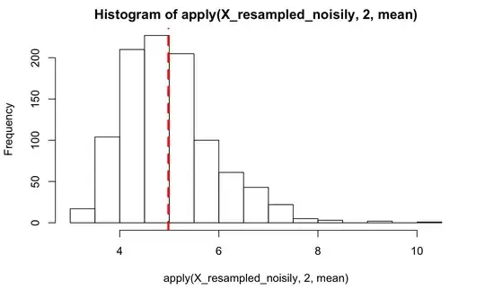

X_resampled_noisily <- replicate(1000, X * rlnorm(L,0,RSE)) mean(apply(X_resampled_noisily, 2, mean))
> [1] 8.216646
hist(apply(X_resampled_noisily, 2, mean)) abline(v = mean(X), col="red", lwd=3, lty=2)

The question seems to be asking if this correction is related to procedures taken in the original regression problem. By the given definition of the regression problem, $Y$ is a variable that is proportional to the covariate $X$ by some log-normal noise whose distribution has a mean greater than 1. So, it stands to reason that the set of points $\{Y_i\}$ should have mean greater than the set of points $\{X_i\}$, and any toy dataset created from $\{X_i\}$ with noise properties that simulate the relationship $Y ~ X$ should also have a mean greater than the mean of $X$. If that is not what was expected, then either the regression model has different behavior than intended, or that expectation -- the motivation behind the "bias correction" procedure -- was wrong, and the greater mean of the resampled data should be accepted as an accurate simulation.
