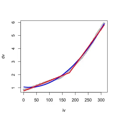

Below are fitted lines from each model polynomial=blue, segmented/piecewise=red, data points=gray
Fitted lines from each model, polynomial=blue, segmented/piecewise=red

Annalise
  • 107
  • A polynomial regression model can not be represented as a segmented model, and
  • a segmented regression model cannot be represented as a polynomial model,
so, this models are not nested (but both are, separately, nested within your first simple regression model). There do exist tests for non-nested models, see this posts: Generalized log likelihood ratio test for non-nested models, Non-nested model selection and for problems with the usual tests Why can't likelihood ratio tests be used for non-nested models?.
On this site it is often recomended to use information criteria (AIC, BIC), see Comparing non nested models with AIC
