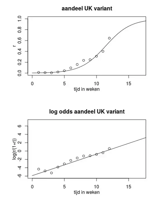

Below you see an example image of the relationship with the logit link function.
The image is an example of the fraction of the UK Covid variant as function of time. This is modelled with a logistic function. Then the logit transformed data (the log-odds) are considered linear. (In this particular example you see that the model is not perfect and it is not exactly a straight line)
In the upper image it is the fraction on the y-axis. In the lower image it is the same data and fit but expressed as log-odds on the y-axis.
logit link
So the fit with a logit function has a linear interpretation in terms of logit transformed data. The coefficients from the output relate to the line in the graph with the logit transformed data on the y-axis.
In terms of the fraction the relationship is non-linear (the upper graph). At different points an increase in the parameter will have a different increase in the fraction. The coefficients will not have a clear/intuitive interpretation in terms of the fraction.
