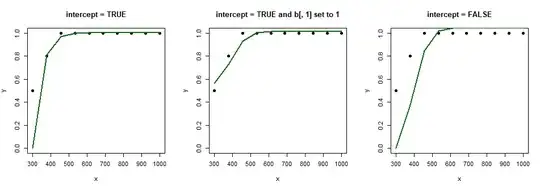

However, with intercept = TRUE, I would expect the spline to start somewhere above the first data point. For instance, this seems to be the case when I set the first basis function to 1.
h[, 1] <- 1
If I set intercept = FALSE, then things go haywire.
Can you please help me understand what is going on, i.e., why is the spline not starting at (300, 0.5)?

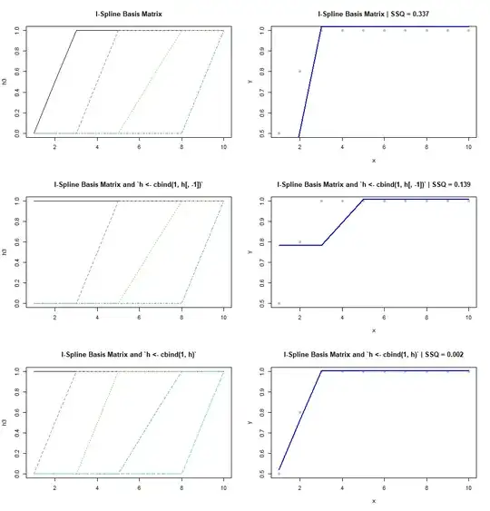

However, in the paper linked above, that's not always the case. Sometimes the author replaces the first column of the basis matrix (i.e., h <- cbind(1, h[ -1]) with the constant function, and, other times, he appends the constant function to the basis matrix.
For instance, if I create the I-Spline basis matrix as follows:
h <- splines2::iSpline(x, knots = c(3, 5, 8), degree = 0, intercept = TRUE)
Then, depending on how I "add" the constant function (or not) I get different splines:
splines_question
What's not clear to me is how the basis matrix provided by iSpline() is intended to be used in this case.

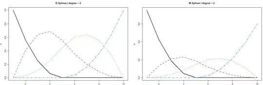

It turns out that both Ramsay (1988) and De Leeuw (2017) use in fact B-Splines, but normalized differently. Ramsay (1988) uses B-Splines that are normalized such that they integrate to one (i.e., these are called M-Splines). Whereas for De Leeuw (2017), the B-Splines are normalized such that they sum to one (i.e., which he calls normalized B-Splines, or N-Splines). Also, it appears that Ramsay (1988) refers to N-Splines simply as B-Splines in his paper. This seems to also be the case with splines2::bSpline() which actually returns normalized B-Splines that sum to one, i.e., N-Splines.
Indeed, normalized B-Splines and M-Splines look the same, and we can see that they only differ with respect to the normalization (i.e., y axis).
# The data.
x = 1:10
The inner knots.
innerknots = c(5)
The degree.
degree = 2
Creating normalized B-Splines and M-Splines.
b <- splines2::bSpline(x, knots = innerknots, degree = degree, intercept = TRUE) m <- splines2::mSpline(x, knots = innerknots, degree = degree, intercept = TRUE)
Plotting the spline bases.
matplot(b, type = "l", lwd = 2, main = paste0("Normalized B-Splines | degree = ", degree)) matplot(m, type = "l", lwd = 2, main = paste0("M-Splines | degree = ", degree))

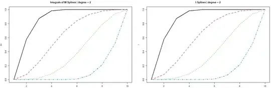

Now, onto creating I-Splines, Ramsay (1988) says that they can be created by taking the integrals of M-Splines. Which is what the argument integral in splines2::mSpline() does, or what the function splines2::iSpline() provides.
# Taking integrals of `M-Splines` and creating `I-Splines`.
mi <- splines2::mSpline(x, knots = innerknots, degree = degree, intercept = TRUE, integral = TRUE)
i <- splines2::iSpline(x, knots = innerknots, degree = degree, intercept = TRUE)
Plotting the spline basis.
matplot(mi, type = "l", lwd = 2, main = paste0("Integrals of M-Splines | degree = ", degree)) matplot(i, type = "l", lwd = 2, main = paste0("I-Splines | degree = ", degree))
De Leeuw (1988; p. 17) refers to a formula (see below) from De Boor (1976) and says:
This shows that I-splines can be computed by using cumulative sums of B-spline values.
To be more precise, I believe this should read as "sums of normalized B-spline values".

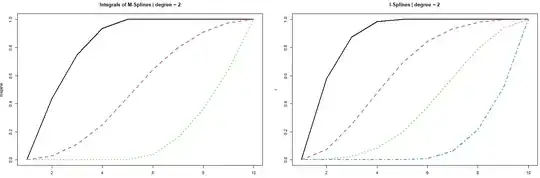

Related to my second confusion, Ramsay (1988; p. 428) says:
We shall use the term order k to refer to an M-spline of degree k - 1 or the associated I-spline of degree k.
I tried to replicate this with splines2, but I couldn't observe the same. For example, I expected to be able to obtain the I-Splines above (i.e., stored in i), constructed with degree = 2, by taking integrals of M-Splines constructed with degree = 2 - 1. But that doesn't seem to be the case.
# Create `M-Splines` of one degree lower.
mspline <- splines2::mSpline(x, knots = innerknots, degree = degree - 1, intercept = TRUE, integral = TRUE)
Plotting the M-Splines.
matplot(mspline, type = "l", lwd = 2, main = paste0("Integrals of M-Splines | degree = ", degree))
But the I-Splines with degree = 2 look like:
The author of splines2 clarifies this in #6 and he points me to the documentation that reads:
The degree of I-spline defined to be the degree of the associated M-spline instead of actual polynomial degree. For example, I-spline basis of degree 2 is defined as the integral of associated M-spline basis of degree 2.

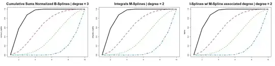

Based on this piece of information and the equation above that links integrals of M-Splines with cumulative sums of N-Splines, it becomes clear that if I want an I-Spline basis of degree = 3, then I can obtain this from integrals of M-Splines of degree = 2, which will be identical to cumulative sums of N-Splines of degree = 3. And, indeed this seems to be the case:

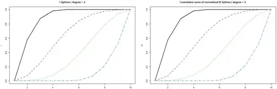

# Creating normalized `B-Splines` of degree 3.
nspline <- splines2::bSpline(x, knots = innerknots, degree = 3, intercept = TRUE)
Computing I-Splines as cumulative sums of normalized B-Splines.
cumsum_nspline <- 1 - t(apply(nspline, 1, cumsum)) cumsum_nspline <- cumsum_nspline[, -ncol(cumsum_nspline)]
Computing integrals of M-Splines of degree 2.
integrals_mspline <- splines2::mSpline(x, knots = innerknots, degree = 2, intercept = TRUE, integral = TRUE)
Computing I-Splines of degree 2 associated with the M-Splines.
ispline <- splines2::iSpline(x, knots = innerknots, degree = 2, intercept = TRUE)
matplot(cumsum_nspline, type = "l", lwd = 2, main = paste0("Cumulative Sums Normalized B-Splines | degree = ", 2)) matplot(integrals_mspline, type = "l", lwd = 2, main = paste0("Integrals M-Splines | degree = ", 2)) matplot(ispline, type = "l", lwd = 2, main = paste0("I-Splines w/ M-Spline associated degree | degree = ", 2))
