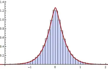

For instance, here is a plot of that PDF superimposed on the histogram of a random sample of $10^5$ such inner products where $\sigma=1/2$ and $n=3$:
Histogram
It's harder to confirm the accuracy of the mgf from a simulation, but note (from the Binomial Theorem) that
$$(1 + t^2 \sigma^4)^{-3/2} = 1-\frac{3 \sigma ^4 t^2}{2}+\frac{15 \sigma ^8 t^4}{8}-\frac{35 \sigma ^{12} t^6}{16}+\frac{315 \sigma ^{16} t^8}{128}+\ldots,$$
from which we may read off the moments (divided by factorials). Due to the symmetry about $0$, only the even moments matter. For $\sigma=1/2$ we obtain the following values, to be compared to the raw moments of this simulation:
 k    mgf           simulation/k!
 2    0.09375       0.09424920
 4    0.00732422    0.00740436
 6    0.00053406    0.00054128
 8    0.00003755    0.00003674
10    2.58 e-6      2.17 e-6
As to be expected, the high moments of the simulation will begin departing from the moments given by the mgf; but at least up through the tenth moment, there is excellent agreement.
