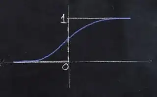

Step and switch-like functions can be thought of as deterministic switches at some threshold, so smooth sigmoidal-like functions describe that switch with uncertainty around that value.
switch vs smooth transition
The machine learning literature discusses 'activation functions' extensively, but the choices are usually justified by application results. I am not aware of an argument for particular functions form first principles.
The heaviside function is sometimes approximated by $H(x) \approx \frac{1}{2} + \frac{1}{2}tanh(rx)$, and I think the gaussian CDF has a more immediate probabilistic interpretation.
Since probability distributions can be described as arising from idealized processes (e.g. gaussian from brownian motion, Gamma from sequence of exponential waiting times, binomial from repeated sampling with a fixed probability) my question is whether there is a canonical choice, or canonical choices depending on the process that generates the step function.
EDIT
The question is not whether there are continuous approximations to the step or Heaviside functions, nor whether there are functions that are popular or commonly used (so it's different from this question) as an alternative to the discontinuous step. The question is whether there are functions that represent probabilistic switch-like behavior and arise naturally from probabilistic reasoning (if not in general, for specific processes that generate some sort of switch).

Depending on the underlying continuous probability distribution(s), different "soft" switch functions may appear.
$ f(x) = \frac{1}{2} + \frac{1}{2} \tanh (rx)$, also known as the logistic function, appears naturally when you have two normally distributed classes with equal variances (or covariance matrices, in a multidimensional case). It describes the probability that an observation with the continuous value $x$ was generated by one of the two classes. You may take a look at this post for details and one-dimensional derivation.
Also, logistic function fits well into the formalism of generalised linear models, through the natural parameter (as its inverse) of the Bernoulli distribution.
Incidentally, logistic function appears in physics as the Fermi-Dirac distribution, where it governs the distribution of a large class of elementary particles ("fermions"), e.g. electrons, over energy states.
The other "soft switch" from your question, the Gaussian CDF, appears naturally when the boundary between two "classes" can be modelled by the normal distribution. This is common e.g. in toxicology, where the exact lethal dose of a toxicant varies between individual subjects (bacteria, lab animals), but this variation follows (approximately) the normal distribution. In that case the Gaussian CDF gives you the probability that the particular dose will be lethal.
So, as you can see, both of your "soft switches" have some connection to the Gaussian distribution, which is quite common, thanks to the Central Limit Theorem. That's probably the closest you can get to being "canonical", and you still have to make some additional assumptions. And, of course, there are infinitely many other distributions and their combinations, leading to different "soft switches", but they are less common in practice.
