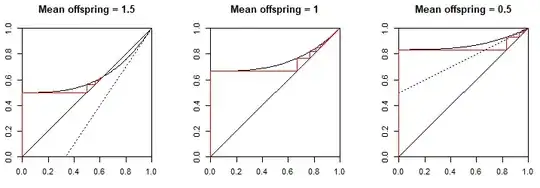

To find $\lim_{n \to \infty} \Pi_n(0)$ graphically, read off horizontally from the y-intercept at $y = \Pi(0)$ to the $y=x$ line, where now $x = \Pi(0)$. Then read off vertically to the $y = \Pi(x)$ graph, where now $y = \Pi(\Pi(x)) = \Pi_2(x)$. Read off horizontally to the line so $x = \Pi_2(x)$. Read off vertically to the curve so $y = \Pi(\Pi_2(x)) = \Pi_3(x)$. Note that all horizontal readings are rightwards and vertical readings are upwards, since $y = \Pi(x)$ is increasing so each vertical positions is above the previous one. This procedure must converge to the first (i.e. smallest positive $x$) intersection point $x = \Pi(x)$, where $y = \Pi(x)$ hits $y = x$ from above. We illustrate the three cases $\mu = 1.5$ ($p_0 = p_3 = \frac{1}{2}$), $\mu = 1$ ($p_0 = \frac{2}{3}, p_3 = \frac{1}{3}$) and $\mu = 0.5$ ($p_0 = \frac{5}{6}, p_3 = \frac{1}{6}$). The dotted blue line is the tangent to $y = \Pi(x)$ at $(1, 1)$, and shows the role of its slope $\Pi'(1) = \mu$ in determining whether there was an earlier intersection.
Cobweb diagram of offspring pgf showing convergence of ultimate probability of extinction
We need the smallest positive solution $\theta*$ of $(1)$. Moving $\theta$ to the right-hand side and doubling to clear out the fractions, we obtain:
$$0 = \theta^3 - 2 \theta + 1 = (\theta - 1)(\theta^2 + \theta - 1)$$
The solutions are $-\varphi < \varphi^{-1} < 1$ so the smallest positive solution is $\theta^{*} = \varphi^{-1}$.
Time to reveal the "fiddle". This link to the golden ratio isn't a result I recall seeing before, but I reverse-engineered it by thinking about the required factorisation of the final equation. Since $\Pi(1) = \sum p_n = 1$, we always have $\theta = 1$ as a root of $\theta = \Pi(\theta)$, so $(\theta - 1)$ must appear as a factor once we set one side to zero. I also knew what quadratic I wanted to see. After that I worked back to try to form a valid pgf. Negative coefficients are disallowed; positive coefficients just needed normalising so they sum to unity. I hoped that the resulting probability distribution for the offspring would be a "nice" one — which I think it is!
R code for cobweb plot
ngens <- 100
par(mfrow=c(1, 3), pty = "s", xaxs = "i", yaxs = "i")
for(p0 in c(1/2, 2/3, 5/6)) { pgf <- function(x) {p0 + (1-p0)x^3} mu <- p00 + (1-p0)*3 plot(pgf, xlim = c(0,1), ylim = c(0,1), xlab = "", ylab = "", main = paste0("Mean offspring = ", mu)) segments(0, 0, 1, 1) abline(1 - mu, mu, col = "blue", lty = "dotted") pextinct <- c(0, rep(NA, ngens)) for (n in seq_len(ngens)) { pextinct[n + 1] <- pgf(pextinct[n]) segments(pextinct[n], pextinct[n], pextinct[n], pextinct[n + 1], col = "red") segments(pextinct[n], pextinct[n + 1], pextinct[n + 1], pextinct[n + 1], col = "red") } print(pextinct) }
