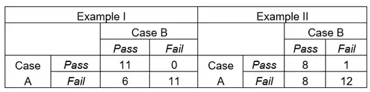

Figure 1, example data

Bootstrapping is conditional on the original sample. The probability that pB<pA cannot really be zero because it is possible that the sample is not representative of the population. The proportion of bootstrap samples for which pB<pA is however zero and this strongly indicates that pB<pA.
