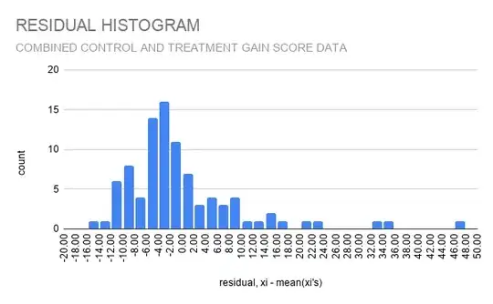

  • As suggested, I am adding a histogram and QQ plot of the residuals gain score (posttest-pretest score) for the test of normality (which I now understand applies to the residuals and not the data itself). I based the generation of the QQ plot from a couple of articles and YouTube videos, I hope I get it right.
Histogram of the residuals

  • Note first that the residuals from a fitted model should be approximately normal, not the data itself. Maybe you can show us some plots, fit a model, show us the residuals (as a qqplot is best). So maybe it can be done ... you could also contemplate using bootstrap to get correct confidence intervals even in nin-normal case. – kjetil b halvorsen Feb 08 '21 at 04:23
  • Oh thanks for that clarification. I'll edit my post to add the QQ plot of the gain scores – MG B Feb 09 '21 at 01:18
  • Thats good! The residuals (assuming you've done everything correct, I'm not sure that only youtube videos are a good way of learning stats ...) have a right tail, meaning that some improvements are too large (compared to a normal). You could try bootstrap ... can you also tell us which software you used, and te code or models you used, with output? – kjetil b halvorsen Feb 09 '21 at 12:35
    I just used Google Sheets since I found articles and videos on how to do the QQ plot by hand, but I am studying R right now to verify what I did.
    I also just found a discussion on bootstrap, and it looks like I can use this to compare my control and treatment/experimental group. Thanks for your help. I'll try to update my post with my results once I'm done.
