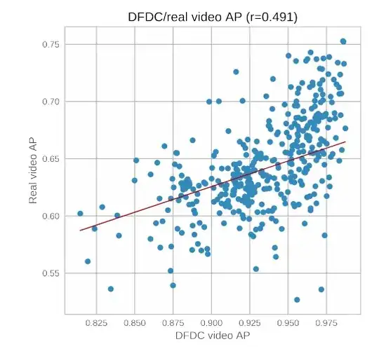

However, they also released a research paper describing the results: https://arxiv.org/pdf/2006.07397.pdf This is the part where I am confused. Research paper does not mention anything about 82% and 65%. Contradictory, in their research paper's figure you can see that Average Precision of the best score was around 0.98 (on the public testing dataset)
