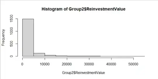

I'm running a test where I need to compare four groups on different dependent variables. Two of them are categorical and I'll a use Chi-squared test for the head-count while one y is a continuous variable: Reinvestment Value. the four groups and statistics with respect to the continuous y are:
  • Control group: n=2749 I don't have the statistics yet
  • Treatment A n=624, mean=3413.9 s2=30269139.5 sd=5501.7, k=12, sk=3.1 enter image description here
  • Treatment B n=38, mean=1546.62 s2=1710133.95 sd=1307.72, k=-0.81, sk=0.82 enter image description here
  • Treatment C n=1708, mean=2528 s2=21949273.2 sd=4685, k=28, sk=4.5 enter image description here
just to clear up all the confusion, I have the actual samples data not just the statistics.

First off, ANOVA is often surprisingly robust to strange distributions. What is important is not that model residuals are normally distributed, but that parameters are (approximately) normally distributed. Here, that would be the group means. You can take a look at this by bootstrapping each group mean. I suspect that the bootstrapped means will be nicely bell-shaped, giving you a little more confidence. (The only group I am slightly concerned about is group B with only $n=38$.)
That said, you could run a permutation alternative to ANOVA. In R, there is RVAideMemoire::perm.anova. A useful textbook is Good's Permutation, Parametric, and Bootstrap Tests of Hypotheses. If you do so, be sure to also run the plain vanilla ANOVA alongside and compare the resulting $p$ values - you may well find that they are very close together. (And note that $p$-values that are astronomically small do not have much more content than "$p<.0001$".)
Stephan Kolassa
  • 123,354
  • Hello Stephan,I have tried what you have suggested and first thing first whe I have bootstrapped my group means and all the sampling means distributions are normally distributed, also the one with 38 observation under alpha 0.05, p-value=0.06. I have also run the permutation ANOVA ( something very new for me) along with the normal ANOVA, I guess it was Eucledean distance since F is exactly the same, however p-values differ with parametric ANOVA <.0001, while permutation ANOVA with 999 permutations=0.001 and with 9999 permutations=.0001, with 99999<.0001, thus which one to use? – VR88 Feb 03 '21 at 13:23
  • Good to hear the results agree. (Anything else would have surprised me.) To be honest, there is little to choose between the two $p$ values. Remember that $p$ values themselves are also random variables, so they have a variance! So don't go hunting for spurious precision. Also, will such a difference in $p$ values actually make a difference in your conclusions? I wouldn't think so. Finally, I recommend Gelman & Stern (2006, TAS). – Stephan Kolassa Feb 03 '21 at 13:55
  • Many thanks, all this is very handy and opening a new line of action; you are right in this case not too much difference anyway still I'll have to reject the H0 which was what simple Anova was saying from the beginning. As Post hoc test would you use TukeyHSD applied on permutation Anova or I can consider Tukey on simple ANOVA reliable enough to see pairwise differences? – VR88 Feb 03 '21 at 14:28
  • Given that the permutation and the "vanilla" ANOVA seem to agree well enough, I would be comfortable with doing post hoc tests on the vanilla ANOVA. – Stephan Kolassa Feb 03 '21 at 15:30
  • brilliant, many thanks for all your help! – VR88 Feb 03 '21 at 15:43
