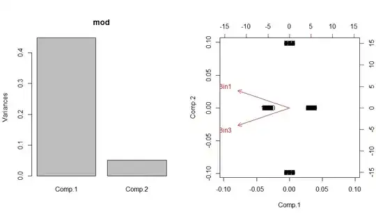

> par(mfrow=c(1,2))
> plot(mod)
> biplot(mod)
Component eigenvalues, left, and biplot (loadings+scores), right:
