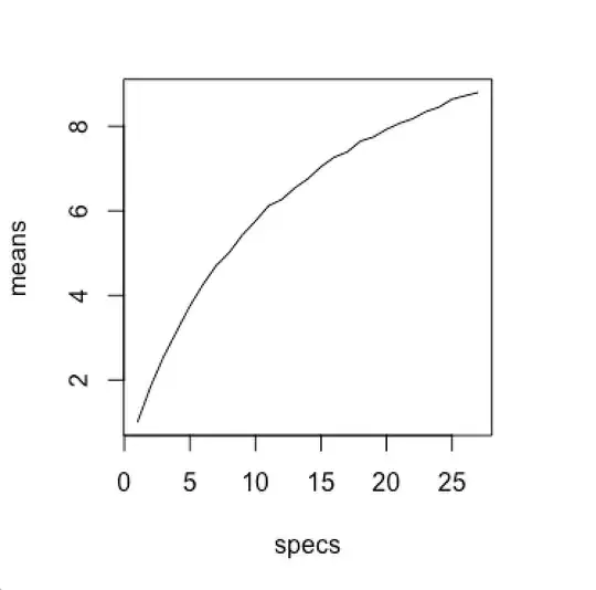

The above data displays the sampling of 27 specimens (specs) along with the cumulative mean number of unique 'types' (means) one would expect to find from randomly sampling specs individuals.
Also included are the standard deviations (sds) associated with the mean number of unique types found for every specimen sampled. Here, the precise meaning of "types" is unimportant.
Sampling 1 specimen always results in finding exactly one "type" and the standard deviation associated with sampling the first specimen is always 0. The above data suggests we can expect to find 8.798 types on average from sampling 27 specimens at random, with a standard deviation of 0.9995971 types.
When the above data are plotted, a graph tending to a horizontal asymptote results. This asymptote corresponds to finding exactly 11 unique "types" (and always with a standard deviation of 0). I want to know how many specimens I likely need to sample to get all 11 "types"; that is, the number of specimens needed to "reach" the asymptote.
$f(\hat{\theta})$ is computed numerically via iterative resampling from an underlying probability distribution and this is how the curve is generated. These curves are generated for different species and show varying degrees of saturation from one species to the next. Thus, fitting a single parametric model to all species is not very realistic.
The above curve suggests that more sampling effort is needed for this species (since the slope of the curve near the endpoint is not close to 0). This makes sense since only 8.798 types out of the 11 total have been found.

I wonder if I can use the 95% confidence interval $(l, u)$ = (7, 10) to get an interval for the number of specimens needed. Using the above approach (the function $f$ is not known), a reasonable interval is
$(L, U)$ = $(\frac{27*11}{10}, \frac{27*11}{7})$ = (29.7, 42.4)
However this interval excludes the value 27. I'm unsure as why this is the case and if there is a workaround.

You have some true interest-parameter $\theta$ and have computed a confidence interval for $\theta$, $(l,u)$. You also have an estimator of $\theta$, $\hat\theta$, which is between $l$ and $u$. That $(l,u)$ is a 95% CI means that $$ \DeclareMathOperator{\P}{\mathbb{P}} \P(l \le \theta \le u)=0.95 $$ I suppose the function $f$ is monotone increasing (it is in the example.) The monotone decreasing case is analogous. Then the above probability statement is equivalent to $$ \P(f(l) \le f(\theta) \le f(u))=0.95 $$ which means that a CI for $f(\theta)$ is $(f(l), f(u))$, and it is clear by monotonicity that this CI will contain $f(\theta)$.
Now there is a complication (see clarifications in comments under the Q.) The function $f$ is not exactly known, it is estimated by numerical simulation. If you can sample enough times to have a small monte carlo error, now the estimated CI $(\hat f(l), \hat f(u))$ where $\hat f$ is the estimated $f$ could be good enough as an approximation. If not, can we save the situation?
