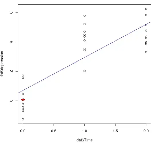

This is a graphical representation of @Alexis's answer - hope it helps.
Here, since the mean of the three groups of Time points do not quite align on a straight line, the intercept of the linear fit does no match the mean of depression at Time 0 (red bar is the mean of depression at Time = 0).
set.seed(123)
dat <- data.frame(
    Time= rep(c(0, 1, 2), each= 10),
    depression= c(rnorm(n= 10, mean= 0), rnorm(n= 10, mean= 4), rnorm(n= 10, mean= 5))
mean_at_0 <- mean(dat[dat$Time == 0,]$depression) fit <- lm(data= dat, depression ~ Time)
plot(dat$Time, dat$depression) points(x= 0, y= mean_at_0, pch= '-', col= 'red', cex= 4) abline(a= fit$coefficients[1], b= fit$coefficients[2], col= 'blue')
fit$coefficients[1] (Intercept) 0.7
mean_at_0 [1] 0.075
