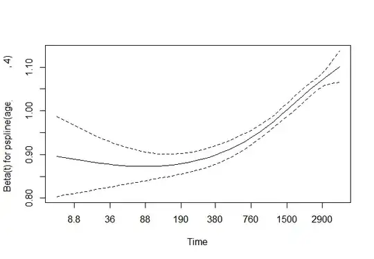

These are the log hazards for the variables age and X. I have now attempted both restricted cubic splines and categorization without meaningful changes to the Schoenfeld residuals.
log hazards for age and X

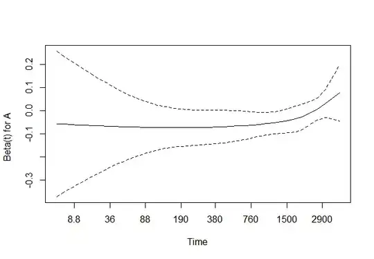

The requested plots from cox.zph for A and age:

With respect to your data set, it looks to me like most of your predictors don't deviate very far from constant hazards over time. The apparently categorical predictors (the last 6) seem quite flat. The coefficient for predictor A does, however, seem to show a tendency to increase over time. There also seem to be more high-positive residuals for X at early times than at late times. You might want to evaluate those more closely, based on your understanding of the subject matter. With continuous predictors (as A and X seem to be), an improper transformation might be the underlying problem, if their values aren't linearly associated with log hazards. Flexible modeling of those predictors with restricted cubic splines might fix the problem.

  • Thank you so much for the great reply! I have attached another image showing the log hazard relationship between age and X. It actually seems to be age that is causing a lot of the problems with the non-proportional hazards. It does not help with restricted cubic splines or categorization - am I missing something here? It appears to be the older ages causing the problems, since restricting age to < 75 fixes the problem. Is this due to the non-linear effect of mortality on age or something else I have not thought of? – Rich R Dec 09 '20 at 06:48

  • Thanks, @FrankHarrell and EdM, for your suggestions. I have attached some of the requested plots and text output of the cox.zph function. Perhaps a way to proceed would be to use the SurvSplit function and interpret HRs for different time spans for the variable I am interested in. – Rich R Dec 13 '20 at 14:36

  • @LarsB note, for example, that the smoothed coefficient for age only goes from 0.9 to 1.1 over the entire time span. Yes, that trend is statistically significant with your very large number of events, but is it practically significant? Similarly, the coefficient for A only goes from -0.05 to +0.05, which is pretty small in magnitude (in either direction) for a binary predictor. Splitting into different periods of time after study entry is a valid approach. The question is: do these differences over time really matter, based on the goals of your study? Also, have you tried AFT modeling? – EdM Dec 13 '20 at 15:55
