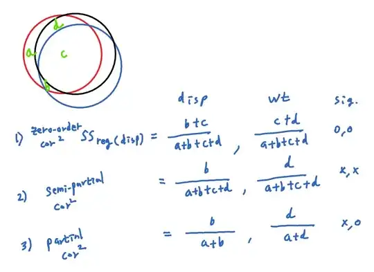

@Noah helped me a lot. Since I am a newbie here, I made some stupid things such as I making an answer thread to ask an additional question. While doing that I noticed low quality answer mark (or something like that). So, I am adding this part to clarify Noah's explanation and why it completes my question.
The initial Noah's answer was like this:
For t-test for an individual IV in multiple regression (lm()), R compares the whole model to the the model without the individual model. That is, for t-testing disp IV, R compares the whole model lm(mpg ~ disp + wt) to lm(mpg ~ wt) (less disp) and see how much additional part is explained by the disp. This is another way of saying t-test in lm function is to see the 'pure regression' part (with the other IVs' parts out).
So, I did spcor.test to see if Noah's answer is working; and, found out that it's not. But, Noah explained that R uses pcor.test instead of spcor.test. And I confirmed that. both pcor and spcor test are ways of seeing the unique contribution of IVs in a regression test. By unique contribution, I am talking about Some of Square part (SS) of IVs, which is usually referred as $SS_{regression}$. The difference is the denominator part. In the picture, red circle is mpg; blue circle is disp; and black is wt. (2) is semipartial correlation squared value; and the denominator part is a+b+c+d (the while SS of y, that is, SS total). 3) is partial correlation squared value; the the denominator is a+b (less the shared part). In the below picture, d/a+d is significant, which is unique explanation of wt without the whole influence of disp part. And for the disp part, b/a+b is not significant, since b is not big enough compared to a+b part. When Noah answered my question, I initially thought he meant (2) instead of (3); and Noah corrected me R uses (3) method in t-testing for each IV.
zero-order, semipartial, and partial correlation squared (SS) in regression analysis. red circ = mpg; blue circ = disp; black circ. = wt
---- added part ends
