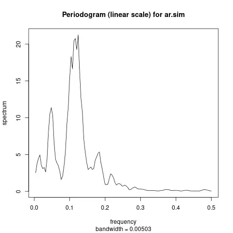

To followup on the last bullet point, let us simulate some (stationary) ar(2) model with cyclic behavior. I am following the example used in this excellent discussion of difference between seasonality and a cyclic series (some of the comments to your post indicates that you really have seasonality, not cyclicity.) The simulation is done in R:
set.seed(7*11*13)# My public seed
n <- 250 ar.sim <- arima.sim(list(ar=c(1.147, -0.6)), n)
library(scorepeak)
peaks <- detect_localmaxima(ar.sim, 5)
plot(ar.sim, type="l" ) points(which(peaks) , ar.sim[peaks], col="red", pch=18)
simulated series with local maxima
The red diamonds in the plot indicates the position of local maxima, and looking at the distance between them could be a way to study period/cycle length. But that is to subjective, so we look for some other approach.
The periodogram is the tool of choice here, trying to estimate which fraction of the total variance in the series comes from different cycle lengths:
ar.sim.spec <- spectrum(ar.sim, spans=5)
Usually this is plotted on the log scale, to show better the details also in the low frequency part of the plot. But here we are more interested in seeing where the main contributions to total variance is, and the a linear scale is more appropriate, since then area under the curve is directly proportional to proportion of variance:
plot(ar.sim.spec, log="no",
     main="Periodogram (linear scale) for ar.sim")
plot of periodogram on a linear scale
We can read the main contribution periodicities from the plot. Since period is inverse of frequency:
 1/c(0.16, 0.08)
[1]  6.25 12.50
