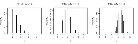

The "appropriate exponential distribution" for the number of bins $K$ is not exponential by any means. It actually is the discrete distribution of parameter $n$ given by
$$\Pr(K=k)\ \propto\ \frac{k^n}{k!}\tag{1.4}$$
for $k=1, 2, \ldots.$
Figure showing barplots for n=2, 10, 50

  • @Ben I wish it were that easy :-). Look harder at the graphics: those are not Poisson distributions. (Their variances are far too small.) – whuber Nov 24 '20 at 22:01
  • Ah yes, I see. Comment deleted. – Ben Nov 24 '20 at 22:02
