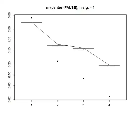

For comparison, let's look at a dataset with a non-random dataset: iris
# iris dataset example
m <- iris[,1:4]
Pnull <- prcompNull(m, center = TRUE, scale=FALSE, nperm = 100)
Pnull$n.sig
boxplot(Pnull$Lambda, ylim=range(Pnull$Lambda, Pnull$Lambda.orig), outline=FALSE, col=8, border="grey50", log="y", main=paste("m (center=FALSE); n sig. =", Pnull$n.sig))
lines(apply(Pnull$Lambda, 2, FUN=quantile, probs=0.95))
points(Pnull$Lambda.orig[1:20], pch=16)
Here, the 1st singular value is significant, and explains over 92 % of the total variance:
P <- prcomp(m, center = TRUE)
P$sdev^2 / sum(P$sdev^2)
# [1] 0.924618723 0.053066483 0.017102610 0.005212184
  • +1. The example of Iris dataset is interesting, because looking at the first two PCs (as e.g. in your own post here http://stats.stackexchange.com/a/88092) it is quite clear that the second one does carry some signal. The permutation (aka shuffling) test indicates that only the 1st one is "significant" though. It is clear that shuffling tends to underestimate the number of PCs: the large variance of the first real PC will get "spread out" across shuffled PCs and will elevate all of them starting from the second. One can devise more sensitive tests that account for that but this is rarely done. – amoeba Apr 10 '16 at 20:27
  • @amoeba - Excellent comment. I have been wondering about the "spreading out" effect for some time now. I suppose a cross-validation test might be one of the more sensitive ones that you reference (e.g. your answer here )? Would be great if you could provide an example / reference. – Marc in the box Apr 11 '16 at 07:17
  • I usually prefer to use cross-validation (based on reconstruction error, as per my answer here), but I am actually not sure if it is not somehow suffering from the same kind of insensitivity or not. Might make sense to try it out on the Iris dataset. Regarding the shuffling-based approaches, I don't know any reference for accounting for this "spreading out", I just know some people who were working on it recently. I think they wanted to write it up soon. The idea is to introduce some downscaling factors for the variances of higher shuffled PCs. – amoeba Apr 11 '16 at 09:12
  • @amoeba - Thanks for that link. It explains a lot for me. I found it especially interesting to see that cross validation in PCA makes use of methods that can operate on datasets with missing values. I made a few attempts on this approach and (as you state) the null model shuffling approach does indeed tend to underestimate the number of significant PCs. However, for the iris dataset, I consistently return a single PC for reconstruction error. Interesting given what you mentioned about the plot. Could be that if we were gauging error based on species predictions, results might be different. – Marc in the box Apr 11 '16 at 15:01
  • Out of curiosity, I tried it out on the Iris data. Actually, I do get two significant PCs with the cross-validation method. I updated my linked post, please see there. – amoeba Apr 12 '16 at 00:22
  • @amoeba - Thanks for that update and the code that you added. Looks like I was probably using the "Approximate method" - I will definitely try pseudoinverse approach in the future. – Marc in the box Apr 12 '16 at 06:21
