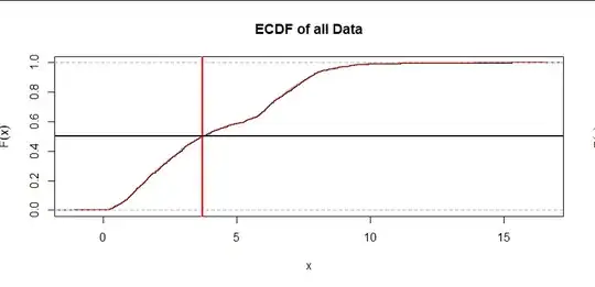

As an example, here are two small datasets of 700 and 300 numbers each, named x and y.
Figure 1: histograms of x, y, and the combined data.
The challenge is to approximate the median (or any other quantile) of the left (combined) distribution based on small summaries of its component distributions (shown in color). For these data, the proposed algorithm summarizes x using $34$ (value, quantile) pairs and it summarizes y using just $10$ (value, quantile) pairs. These summaries approximate the quantile functions to within a maximum error of $0.5\%$ of the range of all the data. (The amount of allowable error can be set to anything, even zero. Zero is an effective choice for discrete data: in this case, the algorithm is equivalent to tabulating the values in each dataset.)
Here is a plot of the empirical distribution function of all the data, $F$ (black), on which is superimposed the mixture distribution $(*)$ as computed from the approximate ECDFs for $F_X$ and $F_Y$ (shown in red):
Figure 2
There are two vertical lines shown: a gray one is located at the true median of the combined data while the red one is located at the root of $g$ (equation $(**)$) computed using the approximate ECDFs. Indeed, they differ by only $0.03,$ which is less than $0.5\%$ of the full range of the data, as intended.
This is the R code that generated the examples. It implements a quantile/distribution function approximator, quantilefun, and shows how to use it for computing quantiles of mixtures of two distributions. It uses the built-in, robust uniroot function to find the mixture quantiles. Because the approximating functions are piecewise linear, they are fast to evaluate, making the search for roots reasonably efficient.

  • whuber thank you very much for your help and your time. Never new about uniroot function in R, new only about optim, I was actually doing numerical search on the mixture function *. I will adapt this to arbitrary number of datasets. I can't export exact values, I'll have to jitter them a bit. – Arktik Nov 12 '20 at 18:01
  • Jittering is a good idea. If you jitter with a maximum error of $\epsilon/2$ and then approximate the ECDF of the jittered data with a maximum error of $\epsilon/2,$ you will still control the overall error of the result to within $\epsilon.$ Dealing with mixtures of more than two components starts getting computationally expensive. You might have to mix two components and then approximate the approximation of their mixture by computing a set of predetermined quantiles (such as all percentiles) using uniroot, then iterate that process over the remaining components. – whuber Nov 12 '20 at 18:06
