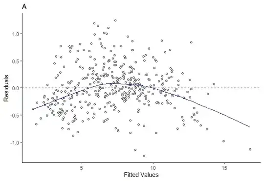

I am working with a set of biological data drawn from a sample of species, specifically a skeletal measurement and body size, with the intent of calculating a regression line to try to predict the body size of new data given the skeletal measurement. As with many biological data, both variables show a log-normal distribution and so I transformed both using a natural logarithm to normalize them.
However, even after transforming both the x and y variables the data does not form a straight line. Visual inspection shows the data is slightly curved and plotting a linear trendline does not accurately fit the distribution of the data.

  • The residuals versus fitted plot for a linear model is distinctly curved

There is not really a name for it. It just means that the relationship is not a power law.
You might model it as a polynomial
$$\log y = b_1 + b_2 \log(x) + b_3 \log(x)^2 + \dots$$
But such form is often not related to an underlying mechanistic model. It would be better to come up with a form that has a better mechanistic interpretation.
One way would be the function above with multiple components and you can interpret the case with two components as two regimes with different exponential coeffients and different allometry.
