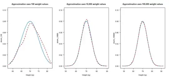

In the example, we know upfront that the humans in our target population have weights that are normally distributed with a mean of 70 kg and a standard deviation of 5 kg. This normal distribution describes the distribution of weight values in the population - you can call it population distribution of weight. The probability distribution of weight describes the distribution of weight values for (a very, very large number of) humans that were randomly selected from the population. We approximate this latter distribution by considering only 1000 humans randomly selected from the population.
When you run the example, you will see that the probability distribution of weight will be close to the population distribution of weight. But these two distributions are conceptually distinct, as they come to be in different ways, as described above. If you consider a sufficiently large number of humans in your Monte Carlo simulation, the shapes of the two distributions will essentially become identical. But for smaller number of humans, they will be quite different. So the number of realizations of the random variable drives how good your Monte Carlo approximation of the probability distribution of weight is; it also drives how close that approximation is to the population distribution of weight.
The shape of the probability distribution of weight depends on the shape of the population distribution of weight. The latter can be normal or non-normal. But the two distributions would have identical shapes (even though conceptually they have different interpretations because they come to be in different ways).
The plot below shows the population distribution of weight (which is the same in shape as the probability distribution of weight) using a blue line. The approximation to this distribution obtained by Monte Carlo simulations is shown in dotted red colour. Note how the approximation improves as we move from 100 to 10,000 to 100,000 randomly sampled values of weight in our simulations.
