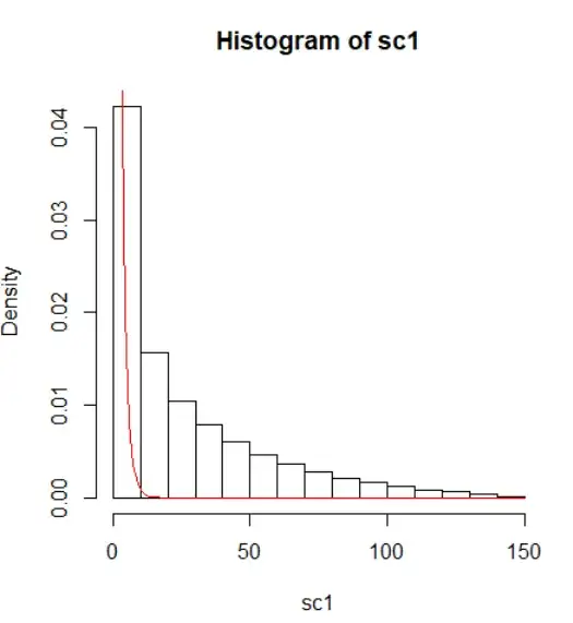

The distribution obtained by the method using random value is shown in Fig.1. enter image description here
Fig.1
The distribution obtained by the method based on round robin is shown in Fig.2. enter image description here
Fig.2
In the both Figures, red line represents chi-square distribution with 1 degree of freedom.
