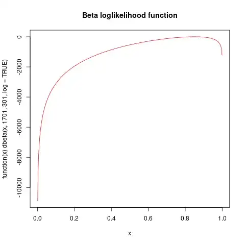

It might be more informative to plot the log likelihood function:
Beta loglikelihood function

    plot( function(x) dbeta(x, 1701, 301, log=TRUE), from=0,
              to=1, col="red", n=1001,
              main="Beta loglikelihood function")
The $y$ value of your maximum (which indeed is at $x=0.85$) is $\exp(-845.42)\approx 10^{-367.16}$. The smallest double numbers R can work with are about $2\times 10^{-308}$. You are simply running out of number space. If you really want to plot this, use a dedicated package for high precision arithmetic.
