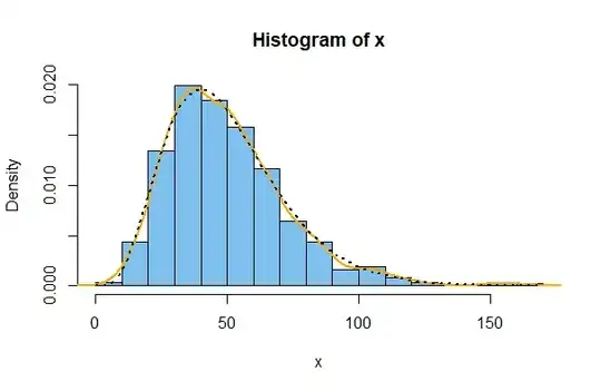

I suppose you have a moderately large or large random sample from a continuous distribution, and that you want to make a plot of the data that suggests the shape of the population distribution.
Then a starting point would be to make a 'density' histogram in which the total area of all bars adds to unity $(1).$ [Similarly, the total area beneath a density curve is unity.]
Here is a sample of size $n = 1000$ from the slightly right-skewed gamma distribution, $\mathsf{Gamma}(\mathrm{shape}=5,\mathrm{rate}=0.1),$ which has $\mu = 50, \sigma^2 = 500, \sigma= 22.36,$ as simulated in R.
    set.seed(2020)
    x = rgamma(1000, 5, 0.1)
    summary(x);  sd(x)
       Min. 1st Qu.  Median    Mean 3rd Qu.    Max.
      6.637  33.938  46.370  49.928  61.942 163.680
    [1] 22.61689   # sample SD
hist(x, prob=T, br=20, col="skyblue2")
 lines(density(x), lwd=2, col="orange")
 curve(dgamma(x, 5, .1), add=T, lwd=2, lty="dotted")
In the figure, the dotted black curve is the density curve (PDF) of $\mathsf{Gamma}(5, 0.1),$ the histogram bars are plotted on a density scale, and the orange curve is the default 'kernel density estimator' (KDE) in R. For a sample of size as large as $n=1000$ it is not surprising that the histogram is a reasonably good fit to the population PDF or that the KDE is very nearly the same as the PDF.
