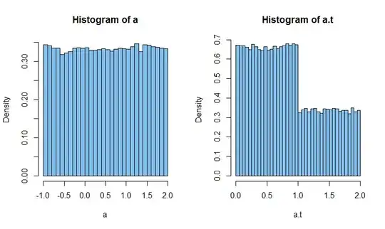

Simulation. First, look at $A \sim\mathsf{Unif}(-1,2).$
set.seed(107)
a = runif(10^5, -1, 2)
mean(a); sd(a)
[1] 0.503862
[1] 0.8682111       # aprx SD(A)
a.t = abs(a)
mean(a.t); sd(a.t)
[1] 0.83735
[1] 0.5536315       # aprx SD(|A|) < SD(Z)
par(mfrow=c(1,2)) hist(a, prob=T, br=30, col="skyblue2") hist(a.t, prob=T, br=30, col="skyblue2")
par(mfrow=c(1,1))
