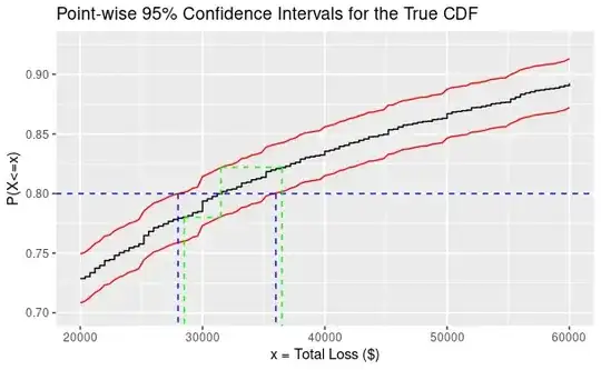

I am trying to provide an interval estimate for the 0.8-quantile of some numeric data, which is assumed to be an IID sample from some unknown, continuous distribution. I constructed an Empirical CDF for my data (black line in the image below). I used the information contained in this Wikipedia article and this review to construct point-wise 95% confidence intervals for the true CDF at many values of x. (These intervals show up as the red lines in the image below. Note that I did NOT find simultaneous confidence bands.)
Estimation of the True CDF
How do you turn bounds on the CDF into bounds on quantiles? I found where the bounds on the CDF reach 0.8. Can I take the x-values of these intersections as bounds for a 95% confidence interval on the 0.8-quantile? In other words, is [28 000, 36 000] a valid 95% CI for the 0.8-quantile? Is it valid to invert the bounds on the CDF in this manner in order to obtain a confidence interval for a quantile?
EDIT: @BruceET The green lines show the method @BruceET used in his answer. Estimation of the True CDF
Using @BruceET's method, the CI for the 0.8-quantile would be [28 500, 36 500]. I think that my approach in the blue lines finds one-sided confidence intervals at different values of x and then pieces those together to find a two-sided CI for the 0.8-quantile. @BruceET's method seems more straightforward. Would one be preferred to the other? More importantly for the purposes of this post, what makes it valid to transform a CI for the CDF into a CI for the p-quantile of the population?

  • This gives me convincing evidence that bounds on the CDF can be inverted to give bounds on a population quantile in the specific case of the normal distribution used in your answer. However, how do we know that this works in general? It's the 2-dimensional aspect of the problem that is really throwing me for a loop. I was thinking of something more in the vein of this question. That post may actually answer my question here. – Escherichia Oct 02 '20 at 20:10
  • Oh, I also just realized that I did it a different way from you. I'll provide a modified picture of what I think you are doing. – Escherichia Oct 02 '20 at 20:19
  • Yes, what method is best may depend on the population distribution. That is why your second link is longer than my answer. // Maybe start by really trying to understand that link. // If you have a particular non-normal population distribution in mind, check several appropriate samples to see how the 'binomial' method works. For samples of small and moderate size intervals will tend to be longer and differ more from method to method. – BruceET Oct 03 '20 at 00:12
  • I don't think we're on the same page. It's not a matter of what method to use to construct a binomial CI for the CDF, but more a matter of how a CI for the CDF can be turned into a CI for a quantile. – Escherichia Oct 03 '20 at 01:20
    Choices for binomial CI are give various answers, see Wikipedia pg on binomial CIs. Then (as in your 2nd link) there are various choices for CI for quantile there. As far as I know there is no one generally recognized 'best' procedure for all situations. Medians are much more often estimated that 80th percentiles. In an addendum, I have shown a third method, assuming normal data and using a parametric bootstrap procedure. // I have shown 3 methods to get CIs, all of which may be useful in some circumstances. If you insist I show any is "best." that is a game I can win only by not playing. – BruceET Oct 03 '20 at 06:00
