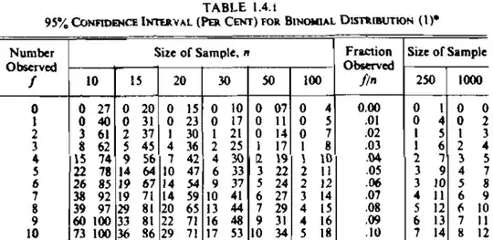

The following table is given for 95% Confidence Interval (%) for Binomial Distribution: enter image description here

Table 1.4.1 from S&C.
In sampling $n = 10$ balls from the urn, you can get any one of 11 values: $X = 0, 2, 2, \dots, 10.$ Consequently, if you use such results to make a 95% CI for the binomial success probability $p,$ you will have any one of $11$ different confidence intervals, depending on the outcome of the experiment. Some of these 95% CIs will include the value $p = 1/2$ and some will not. We can call the ones tha cover 'good' and the others 'bad'
I don't know what style of CI S&C are using, but I can show results from one reasonably accurate style of CI. (This is done with the caveat that $n = 10$ is a very small sample, so we can anticipate some 'wide' confidence intervals.)
A 95% Jeffreys CI is based on a Bayesian argument, but it is often used by frequentist statisticians because it has good properties. If there are $x$ Successes in $n$ trials, this CI is found by taking quantiles $0.025$ and $0.975$ of the distribution $\mathsf{Beta}(x+.5, n-x+.5).$
So lower confidence limits lcl and upper confidence limits ucl of such a CI can be found in R as below. Table 1.4.1 expresses these limits in percentages, so I multiply by $100.$

Lower limits $0.0, 1.1, 4.4, 9.3, \dots, 78.3$ are roughly the same as the lower limits in the column n = 10 of Table 1.4.4, which are $(0, 0, 3, 8, \dots, 73.$ UCLs are also comparable.
Then, the issue arises, which ones of the 11 possible CIs include probability $1/2$ or $50$ percent (i.e, are 'good'). For my Jeffreys CIs, the answer is the CIs for 3 through 8 successes. [For the CIs given in S&C's table, the 'good' ones are the same.]
Finally, the 'coverage probability' of a CI for a particular probability (1/2 here) is the sum of the binomial probabilities that match 'good' CIs. That's about 98%. Because of the discreteness of the possible results, it turns out that there are 'lucky' and 'unlucky' values of the success probability $p$. One hopes that for most values of $p$ the coverage probability is near the promised '95%'.
